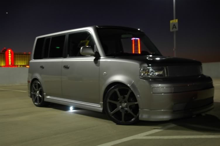

Offsets and flares? my favorite topic!! You gotto go low to match flares. Teh small sportmax's that everyone uses are a 0 offset and goes flush with the fender flares everyone else uses. I'm not into those types of rims and flares, but here some eyecandy for you.
+25 front and +20 rear
offsets in the minuses with metal overfenders
again, like a -20 offset. wooo woooooooo!
P.S. I got a straight on rear shot of the Blue bB. wheels are like -15 degrees camber!!!!!
I likey the impact look. ya think?
