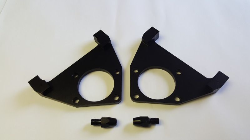

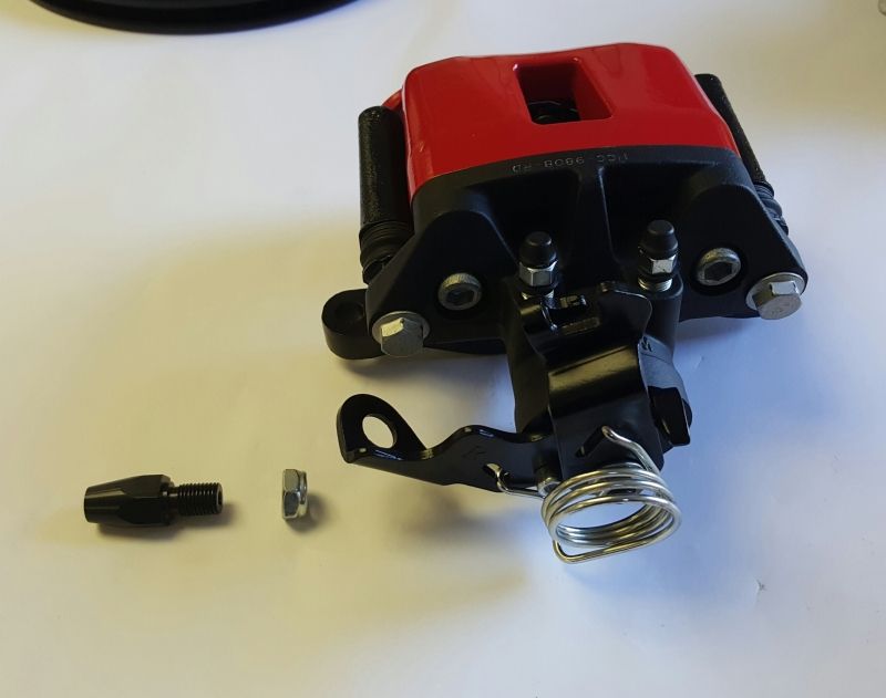

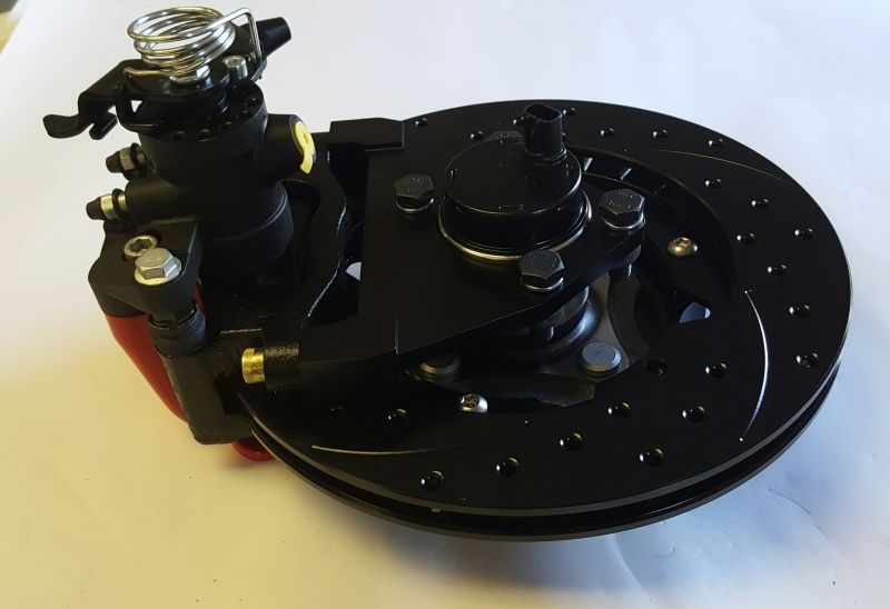

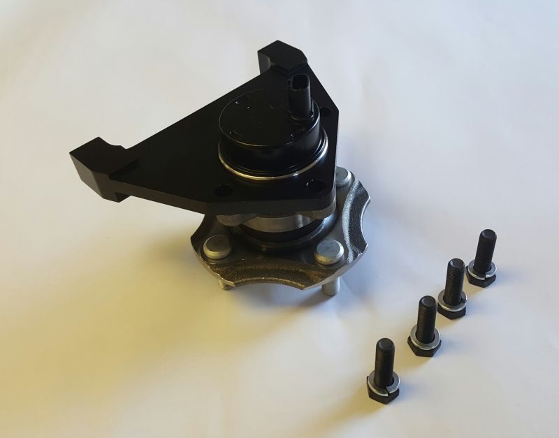

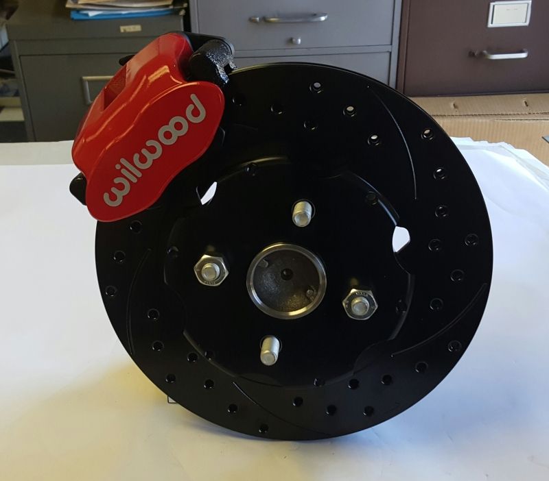

As some of you may know, I designed a rear disc brake conversion about 8 or 9 years ago. They are going strong, but the calipers are getting harder to get at a reasonable cost now. So after the help from a friend and a little push to do it, its now done. A New Wilwood Disc Brake Conversion using a combination of Wilwood components and my machined components. Please PM me for more details. I hope you like it and enjoy!

This Wilwood conversion costs $1250.00 plus $45.00 for shipping.

I also offer a conversion that uses Toyota Corolla GTS Calipers and Toyota MR2 Rotors. The kit posted in this post is basically an upgrade to the original.

The original kit with the Toyota parts will work with 15" wheels. The Wilwood requires 17" or larger.
