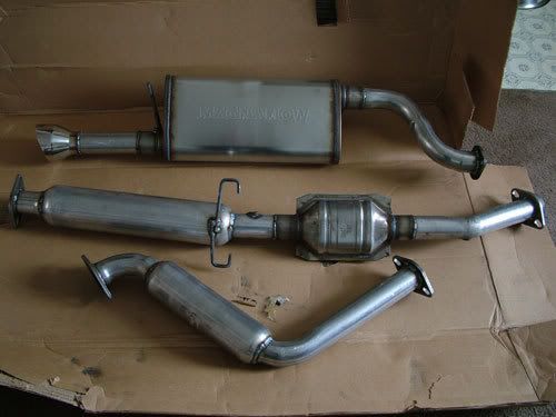

Wow that looks awesome. If you don't mind me asking how much did it put you back and I assume shipping was not that big of a problem.
Looks awesome!

Just PM Stylis on this board for a price. He is Precision Muffler. He'll take good care of you!!! Excellent customer service!! And yes this was shipped to me. It's a complete 2.25" header back bolt on system.
Awesome thanks man. What does it sound like on the highways at constant higher rpms? And do you like the second resonator that much more or was it a waste?

It doesn't have a loud drone at freeway speeds if that's what your asking. It has a nice tone but not overwhelming. The second resonator was recommended as away to keep the tone lower (less "honda" if you know what I mean) and no it was not a waste. I had a MagnaFlow Cat-Back system before and it got annoying after a while. So when I decided to "fix" that problem and go with a complete header-back system, Stylis over at Precision Muffler recommended the second small resonator. He has done extensive testing of the flow of this system with both the single resonator & double resonator and you don't really loose much flow. Plus, these aren't really resonator's but rather glasspacks. He puts them in "backwards" (fins facing back rather than front) which helps the flow and still cuts down on the db level. I can tell you that this is a VERY GOOD system. Easy to install and it seems very well balanced, torque wise, with the engine and other performance mods I have. I also have a short ram intake, lightweight pulley and DC Header. This I/H/E/P combo is great. Plus it just makes more sense that if you have mods like I/H why would you just do a cat-back or even worse a axle-back, so the flow is great coming in, then great going out till it gets to the end of the header, then gets pinched by the stock exhaust & cat then get better flow after that? I feel it gives the engine better performance over a cat-back system and lets face it the only reason to do a axle back is for sound NOT performance.Not to mention this system sounds much better than both of them as well. The best part about this system is that it's not much more than a cat-back system and makes a lot more sense from a performance standpoint.

rbarrett, already PMed you back. This system was dynoed back in 2003. The scion xA/xB has 94hp to the wheels stock. With this system we got a dyno result of 101hp to the wheels. This was on my xB way back in the day, and this was with 18inch heavy wheels on it too. :D

I love the look of the rolled tip. Is the entire system stainless steel? Also, did you do any tuning when it was dynoed? I was wondering if the car started to run lean. Does it still run well on 87 octane?

The entire system is not all stainless steel, it uses aluminized pipe. Its still great metal. No tuning can be done with a stock xB, there wasn't even a turbo kit available in the US back then. :D Actually I was still using 87 octane back then too. The car should never run too lean anyway with the VVTI working its magic, the cat is still there so there is no check engine light.
