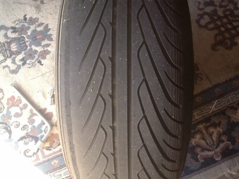

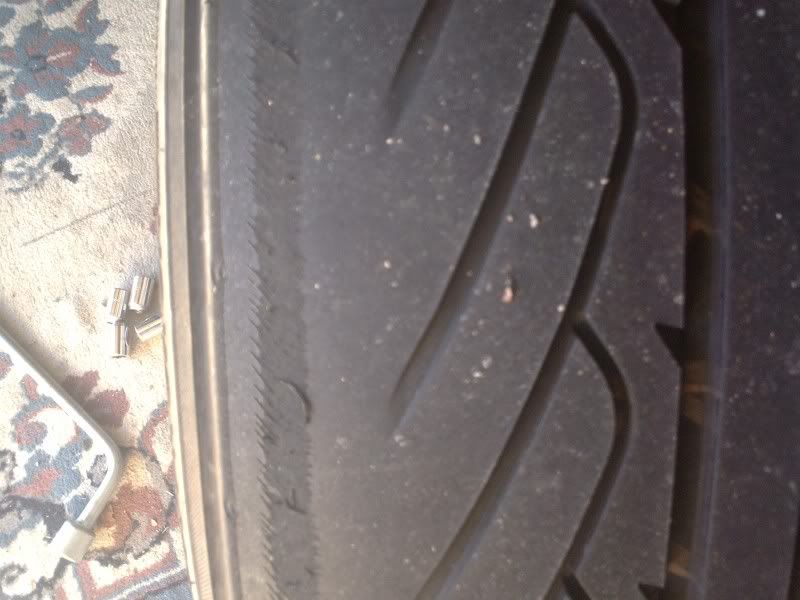

well heres my rear tires as of yesterday.
outter half
Inner half!!
only 6k miles on em.
i'm running -5 camber for those who don't know.
My response in SL form: Camber is so damn stupid. Im a mechanic, and I think you are crazy for RUINING a good tire like that. What a waste.
My real response: Friggin hot. Gotta pay to play! Cant wait to see the ride all done! Next time just try flipping the tire on the rim, and youll get some more mileage outta that bad boy! :D

lol love the 2 different post modes there. yeah i'll take better care of the next set but you know about all my fitment issuse with this set so i was hopin they'd wear down quickly. plus these were cheapo arerican tire co. tires thats why they wore down so quickly too. gonna get a 215/40 instead of the 225/50 i got now

Thats why I refuse to camber my wheels. I prefer having tires that last more than a year.

I was reading somewhere that wear that is that bad when you have camber is more from your tow being off than the camber. But camber isn't really my thing so I could be wrong, just thought I read that somewhere.
612 Posts
Camber (leaning to one side) will wear tires out at a normal rate, just on one side. Toe (pointing left or right) wears tires out at an accelerated rate by being dragged. Toe sucks, man.
Are both sides like that? Did you ever get an alignement? Curious to know the toe specs. My toe is a bit off on on one side (w/ 3deg Garsons), but I haven't put on enough miles to see how bad my tires are wearing.
