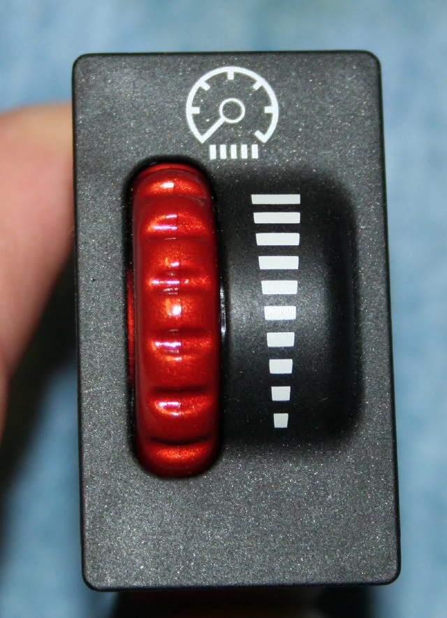

Well I painted one more thing in my interior, the dimmer switch. Once you remove it from the dash you have to dis-assemble it
Push in the tabs on the back and slide the guys out.
Once the guts are removed, you can remove the knob by pulling it straight off. You dont have to loosen anything, you do need to note how the dimmer was oriented, if you look under the bottom of the dimmer you will see it is keyed and does not turn a complete 360 degree's. So if you put it on wrong it will not dim or brighten your lights completely. I set the knob on a small socket to paint, let it dry a few hours, cleared it and let it dry again a few hours then reassembled and installed.
And the finished dimmer looks like.

Here is why I painted the dimmer.
and

But Skeeter (and others).. what if someone screwed up the dial.. where could someone get these parts? Just in case I really mess something up. :mad:
1,367 Posts
Discussion Starter · #6 · (Edited)
The knob just pops on and off, but if you screwed it up just like any other part then you would have to make something or go buy the whole part from Toyota. If you do any mods its at your own risk.
