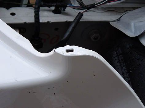

I cleared my headlights today and followed instructions that I found on that "other site". The instructions were helpful until it came time to actually remove the bumper. I took out all of the screws but it still wouldn't come loose. I pulled and prodded for a while and then gave it the Ford move...pulled hard. It popped loose and then I found out why it wasn't coming off. There is a tab that goes through a hole in the top of the bumper. The tab is on the headlight housing itself. Once this tab was released the bumper came off just fine.
Here is the hole that the tab goes into:

Yeah, I hate that tab.
whoa whoa whoa. i dont have that tab on mine. so the tab is on the fender? or on the headlight?
ive had my front bumper off over a dozen times (ive had almost every body panel off the car now). theres no tab on mine like that. does everyone else have one?
It should be there, I broke them off my dual halo's because they where shaped wrong and I didn't have a grinder.
All the OEM lights have them.
hmmm weird. ive had my lights off twice and never noticed any tab there. i might have to rip my car apart this weekend since its dead anyway. i dont remember any tabs though at all.
