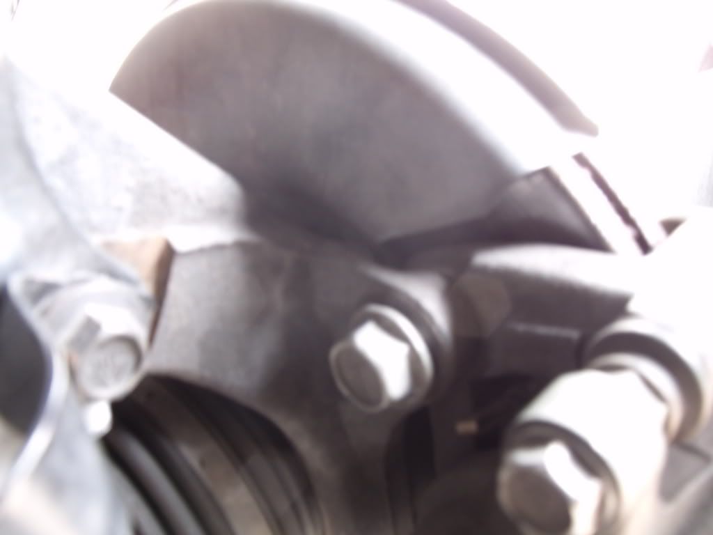

2. Now attempt to remove the 2 bolts that hold the brake caliper over the brake rotor.Please dont confuse these with the bolts that u can use to change the brake pads without completely taking off the whole caliper.pic of one of the bolts behind

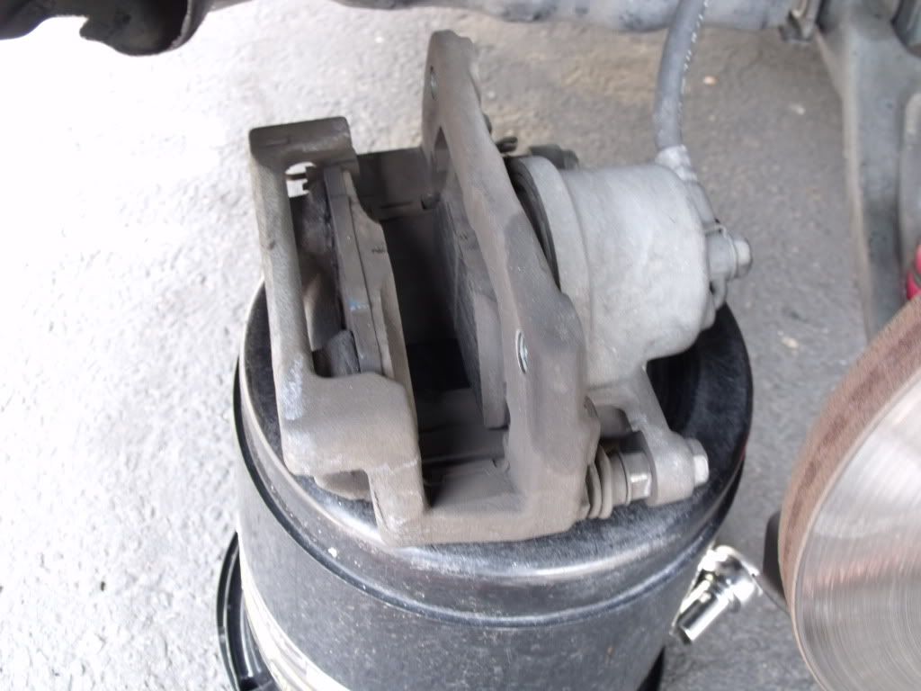

3.After u remove both bolts remove the brake caliper and this is what you should see
4.I would suggest laying the brake caliper on a bucket to prevent stressing the brakelines.

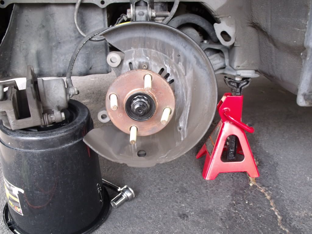

5.Now remove the brake rotor and you should be staring at the hub assembly with the old studs

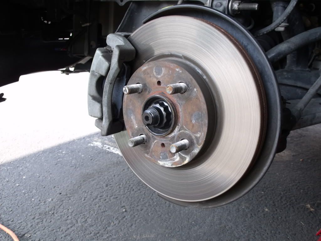

8.Now inpect the new studs and get ready to put them into the empty hub
9.Insert the new studs into the hub.This can esily be done by rotating each hole towards the brake caliper location where a small indentation in the brake back plate esixts to make inserting studs easy

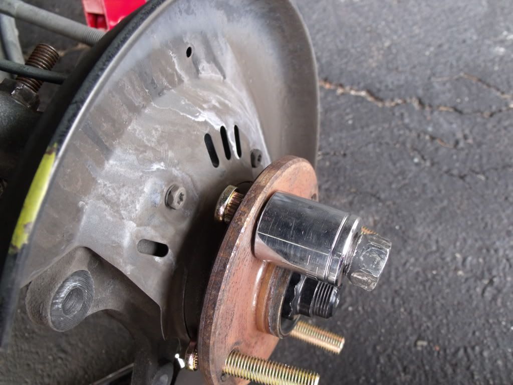

10.Now the next step is to make sure the studs sit properly into the hub.This where the impact comes into play.I used 2 methods here.pick ure poison
Method one involves using a socket in between the hub and a lug nut to jam the bolt into place
or method 2.Use a bunch of wrenches stacket together in between the bub and the lug nut and jam down with the impact
11.Do this for all 4 studs and you should be staring at a hub with newly done studs
Make sure when u install the studs that they sit flush onto the back of the hub just as the oems did or u run the risk of having loose wheel as you drive.
