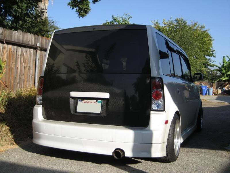

Originally Posted by stankubrick View Post
Brian, is that 15x8 +25/10? Are you running any spacers in the rear? How low are you? I was thinking of getting 195/55 too for my 15x8 steelies...
That is the correct offset but you need to know a few things about that pic.
when that pic was taken i was still on my winter suspension (TRD springs/struts etc) so its only a slight drop. I also had OTG 10mm rear hub spacers so that offset is actually 0 in that pic. thats why it sticks out so much in the rear.
I have one pic of the car on my coilovers (D2's set around a 3 inch drop) and OTG rear camber plates. No spacers. Sorry about the angle, it was taken from a deck at the beach house we were staying at last summer.

i have the same wheels only im using 195/50 and on tein basics all the way down... the pics have bad angles but these are the only ones i have at the moment. i hope it helps.

infekted is ur speedo off?? and even if there is it isnt by much is it??
mikkoxB is offline   Reply With Quote
Old 02-09-2007, 07:02 PM   #12
infekted
-[bB SQUAd]-
Join Date: Jan 2006
Location: LO*CAL
Posts: 603
infekted is on a distinguished road
Send a message via AIM to infekted Send a message via MSN to infekted
yeh, its off by 4.5% so if it says im going 60mph, im actually doing like 57mph.
