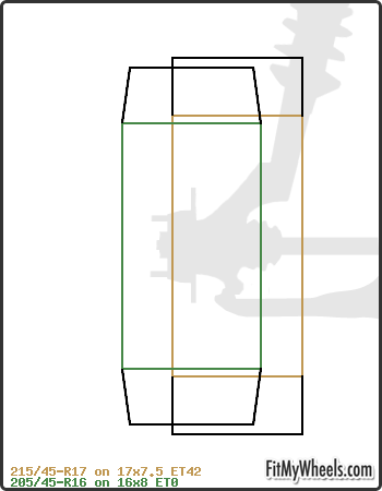

Originally Posted by TIM747 View Post
DeadCannon: On that site, if the wheel and tire do not go past the stock on the inside, that means the suspension and such will be fine? That site is hella useful, thanks!
Yeah, it should be safe. You should be able to have a little bit of room to mess with. You might want to take a peek in there while you are still riding stock. A lot easier to get in and take a look.
Since Cody doesn't really have a data base of fender clearance it may require some measuring on your part to figure out if it will fit. I've also asked him about implementing a camber option.
For my new wheels I started by looking at my current setup vs stock, just to be more familiar with what I'm working with now. Honestly I did very little research before buying my XXRs. I found a 16" wheel in 5x100 and low offset that I could afford. End of story. Not the best way to do it but I made it work.
stock tC 17x7.5 +42et & 215/45 vs 16x8 0et & 205/45
As you can see the wheels are only 1/2" wider but because of the massive camber difference the wheel is pushed way out.
Next I did proposed setup vs stock. I wanted to check inner clearance. I am planning to go much wider and wanted to be sure I wouldn't be in danger of rubbing the shocks or control arms.
stock tC vs 17x9.5 +31et & 235/40 (still kicking around tire sizes)
As you can see in the image the interior clearance is almost identical to stock. No worries.
After that I checked my new setup versus my current setup so I can see how the poke will be compared to 8" 0 offset. With enough camber the 8s fit with a little rubbing.
16x8 0et 205/45 vs 17x9.5 +31et 235/40
So I guess I basically typed all this just to give an idea of what the thought process you go through to figure out your fitment before you spend your hard earned money on something that you hope works. Maybe it's useful, maybe it's not. XD I did none of this because I'm not particularly bright. :-P I just wanted to be the first tC to run 16s and make it work.

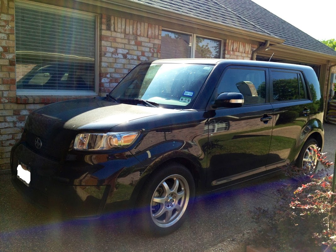

I'm not dropping supalow anytime soon, I think. I could spend all my hard earned money this summer on just air suspension, or I could get springs, wheels, seat covers, exhaust, CAI, various lighting, and more for the same amount. I would love to just have the 75% complete setup for a bit, then sell the springs and go on air later. That site is pretty helpful, but fender clearance would be good. I hope Padanky sees this thread, he's running a similar setup except he has 18x10 not 17x10. I want to run the mustang wheels so bad, and the offer is great. You can buy tires from them (poor selection however-suited for mustangs, not stance), have them mounted, balanced, and filled with nitrogen if you like, for no extra charge. Hopefully, their techs will stretch the tires onto the 17x10. They only have Sumitomo and Nitto in stock, so I'm iffy on that. I really wish I wasn't a minor haha, I want to buy the wheels on my own. I hope no one mounts these before me, if my dad makes me wait till I'm an adult to buy. I wish my dad hadn't bought those crummy MB Seven-X when replacing the tires, otherwise, I would be fitted by now. Hopefully, I can ram into a curb and crack them haha.
Here's how she sits now:
Should I just run air for a year, and tuck these? I'm so indecisive on what to do. I want to either have deep concave wheels, like the XXR 527, lipped wheels, like the mustang wheels, or step lip wheels, like the XXR 521. The race look of the RPF1 is awesome too. The main reason I like the mustang wheels so much, is because of the combo of price and fitment and benefits of ordering them, and because they're so unique. Maybe only 5 japanese cars in the world run them. The internet shows 3, from what I've seen, and I threw a couple in. The way these look is phenomenal.
