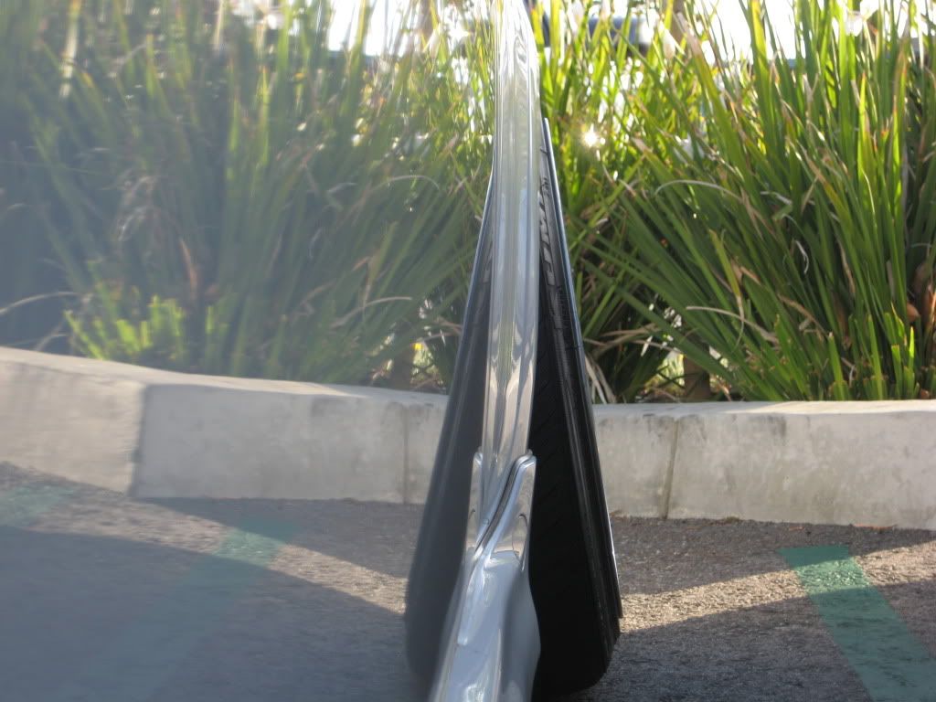

Depends on how low you are or want to go, -5 will clear with fender rolled and -3 slammed is cutting it close.

im rocking 16x9 +15 in the rear with an extra 10mm and -5 shims and this is how it fits.

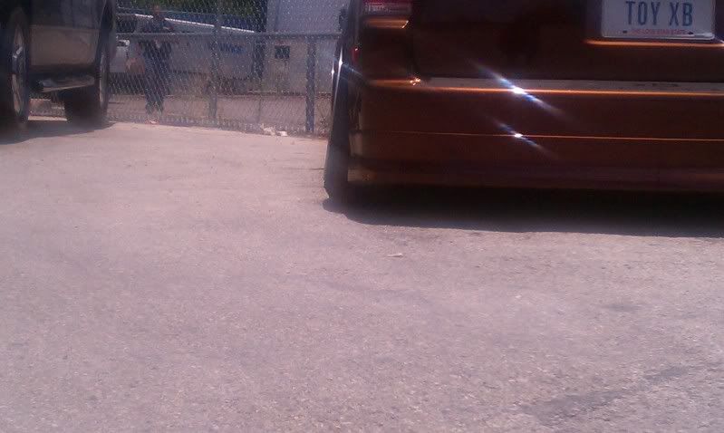

16x9+15f, 16x9+5 rear. Running a 10mm spacer in the rear with -5 camber also.

If you do 16x9+15 up front your gonna have to space the front fenders, mine are spaced just over a 1/2" on each side.
