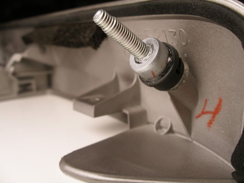

Common problem with the end studs pulling out of the rear hatch garnish. Sometimes the boss gets cracked too, so here are few pics showing a reliable fix:
Snap in wire grommet from hardware store. It's 1/2" OD and fits tight over the boss:
Will need some epoxy:
Make a small hole at the bottom of the boss:
Glue the grommet and make sure the top is flush with the boss:
Get epoxy on the stud and push it in. It's gonna be a very tight fit- using a deep socket helps. You can hold the garnish with your knees and carefully hammer the stud in:
Will look like this when all done:
