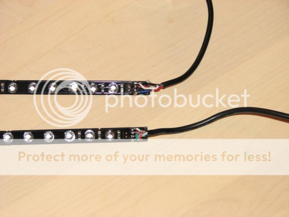

Now here is the delicate part of this operation. Set the dremel to low speed...You can see from the picture the very edge of the black LED bar. You will be cutting into the end cap, parallel to this edge. Do not cut very deep a little at a time....If you've used a dremel before you'll be able to 'feel' when it breaks through the plastic, RPM's increase and there is no drag. Cut both sides and go slow when getting to the wire. If you blast through the plastic like Rambo through your mom, don't fret you shouldn't hurt anything.
After you have gently cut through both sides of the end cap, pry it apart with a blade tipped screwdriver. And gently dislodge the wires from the remaining half of the cap. Small blade screwdriver comes in handy here
Now get the superglue and put a dab on the wires right where they meet the solder (in a sense locking those wires in place for now) and wait for it to dry. Then slowly and gently start peeling the 'factory' glob of glue off the wires. You wanna do this so that they can lay flat later on.
This picture shows the top one done and bottom one unfinished
All done....
Now solder the broken wire(s)...cuz you know you will break some!! And tuck the wire around the back of the bar and tape that end with electrical tape to help secure it.
