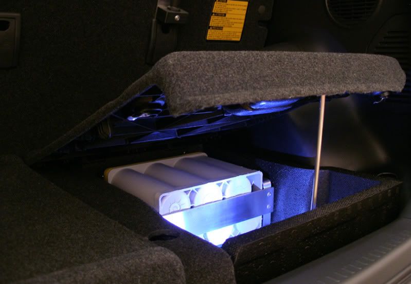

Relocation. That's the only one i've been running: http://www.clubxb.com/forums/showthread.php?t=25943

sweet post there. I've got a some subs that i'm still setting up that are run the same way, building into the floor I'm going to put up a post when i'm done to share with everyone.
So it looks like Optima yellow is the way to go if you're running electronics like i am. My buddy wants me to go full montie w/ the blue (marine) but it seems unnecessary. I still have questions regarding if i'll need a high output alt or not. i've heard of people mention it here and there, but noone here seems to say anything about on clubxb regarding that. Just wanting to know if it's important when doing a battery upgrade and electronics mods.
