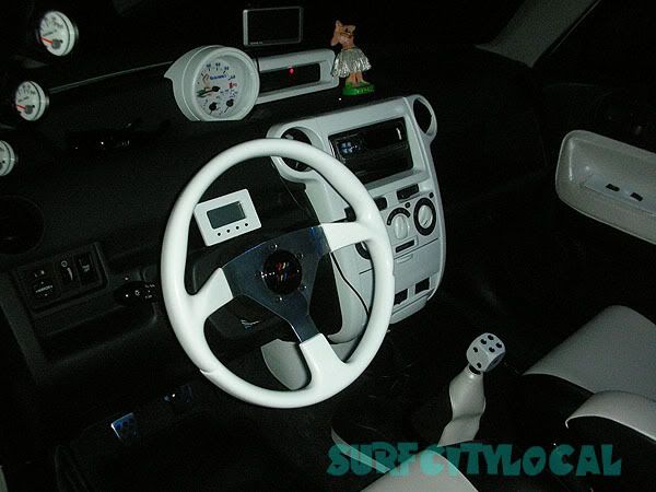

I have done all my interior pieces using adhesion promoter and Krylon Fusion paint. I did not sanding. I just made sure all the parts were clean and dry. The result was clean and easy.
