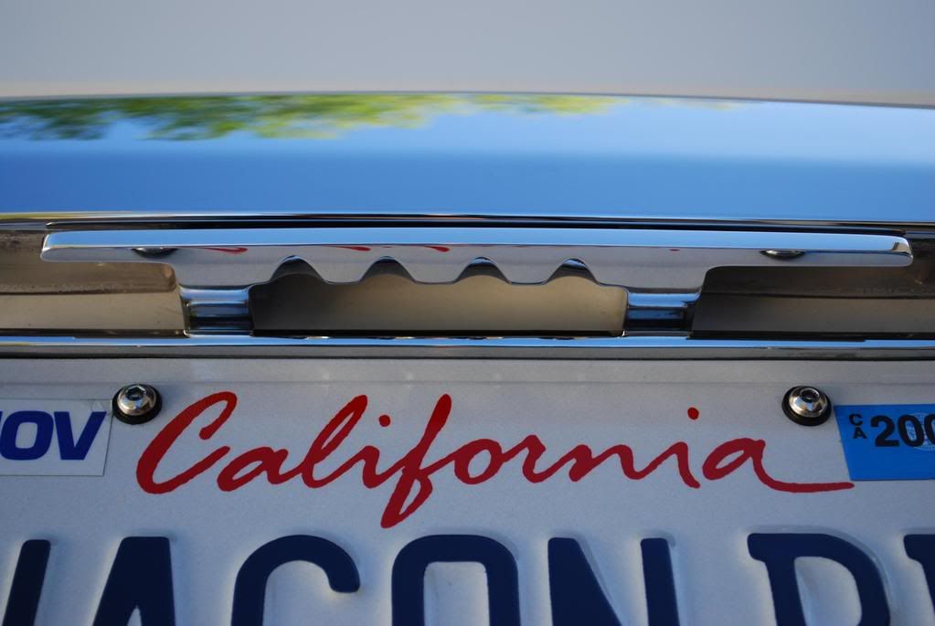

I know the feeling! Are you gonna do something like that in the bumper, since your hatch is JDM?
Originally Posted by ToyBox_02 View Post
I will be ordering the chrome hatch handle cover to see how it looks with the chrome finger handle.
Should look all right. Probably will be somewhat similar to Sakura's chrome garnish and the handle:
