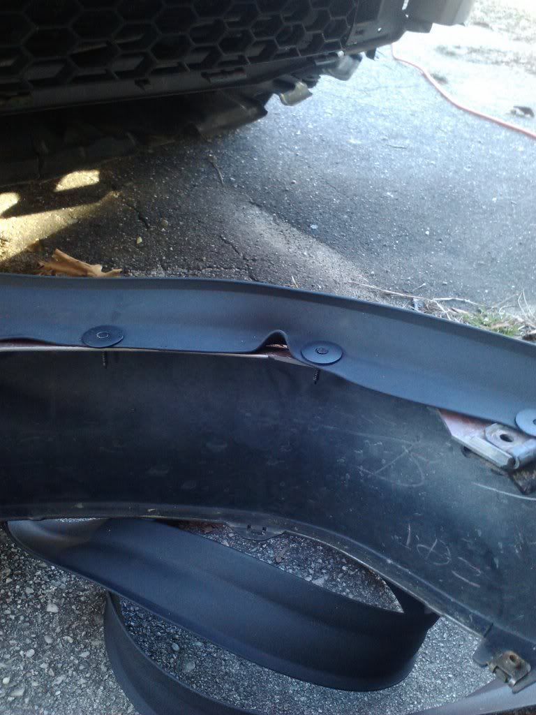

Step Tow, Drill and hammer. Line up the garage door lip with your bumper and drill and hammer the mounting pins.
Slice the little "bubbles" in the corners to help it conform it to the bumper.

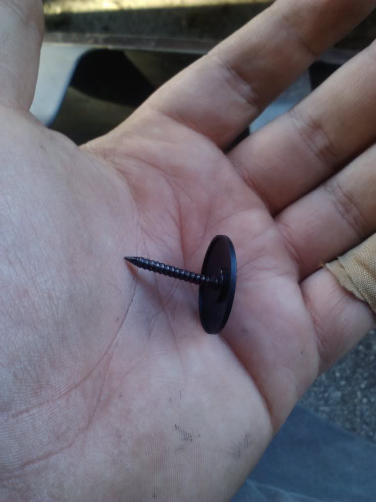

I used the supplied little tab/nail things to secure it to my bumper , you could use 3M double sided tape but you have to make sure your bumper is squeaky clean and if you leave in a very WET environment I dont recommend using it.
