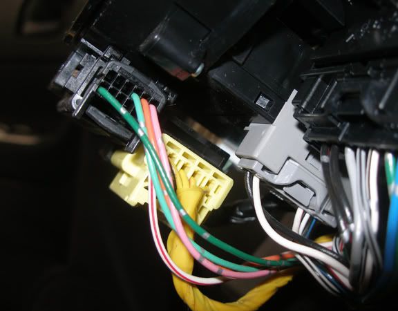

Has anyone found out how to stop this? I removed the 40Amp ABS#1 fuse, so the car no longer break checks me. But the annoying alarm keeps going off. I just swapped the steering wheel. Ughhh it looks soo good i wanna keep it.
Did you have to remove the airbag spiral cable assembly from under the new hub?
No i still have the air bag hub on to fill up the space behind the new steering wheel hub. Im going to try and unplug the 3 wires connecting to it. Hoping that does something.

Did you install the resistors like shown here: http://www.clubxb.com/forums/f17/diy...ght-17081.html ?
No, i didnt even see that! You think that will help?

Whenever you remove the airbag this trick is a must do.
Well then, looks like im going to the store now! thanks again! After i get this figured out next is getting the horn to work! Found the DIY on that!

You can also disconnect the Yellow connector from the spiral cable and connect the resistors there instead. May be more convenient than jamming them inside the hub, but it's up to you:
2 pairs of wires need to have the resistors hooked up to. One pair is Yellow and Yellow/Black and the other is Yellow/Violet and Yellow/Orange.
I just tried to do what is shown in the DIY, went and got 2 3 ohm resistors and plugged them into the air bag wires and still nothing?

Disconnect the battery for a minute. Is the ABS fuse back in?

Re: Traction control
You can stick the resistors in the back of the yellow connector in the pic i posted. Just need to be sure they make a good contact with the pins. But it's basically the same as connecting them inside the hub.
