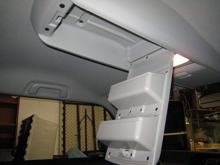

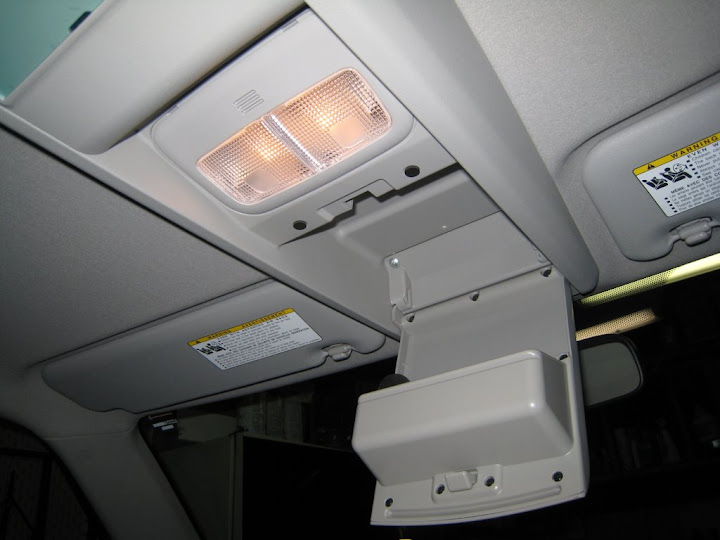

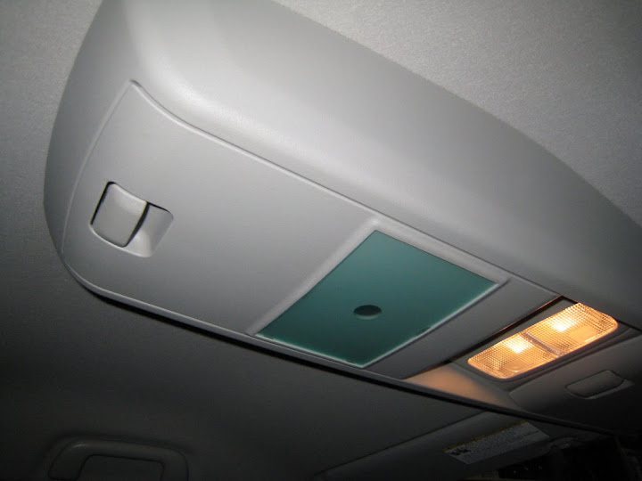

yes it matches, but the picture on Scion site is off, it actually has two compartments, one in the front before the map light and one in the rear. it goes from the windshield to about 2 inches from the dome light.
Daoiid is offline   Reply With Quote

sorry it took so long was at work
overhead-console-install-myself-image_002.jpg  overhead-console-install-myself-image_003.jpg

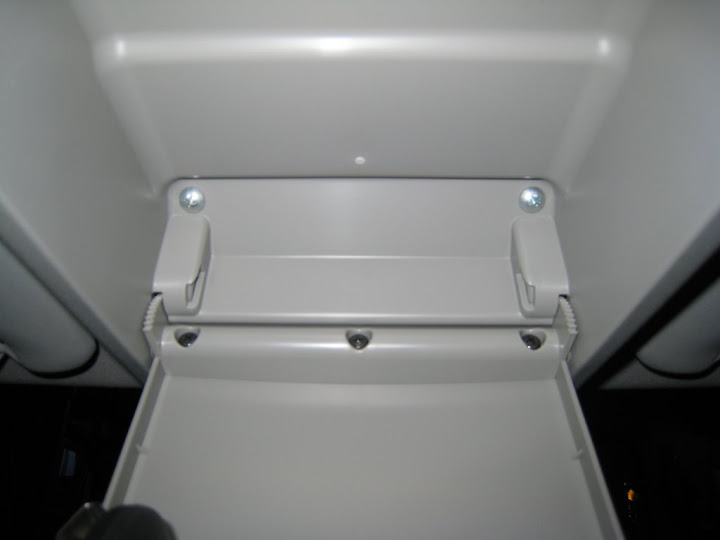

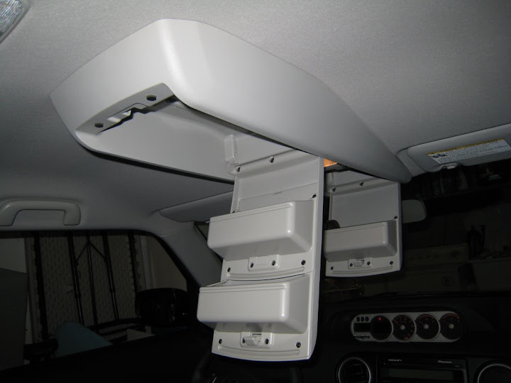

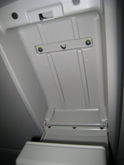

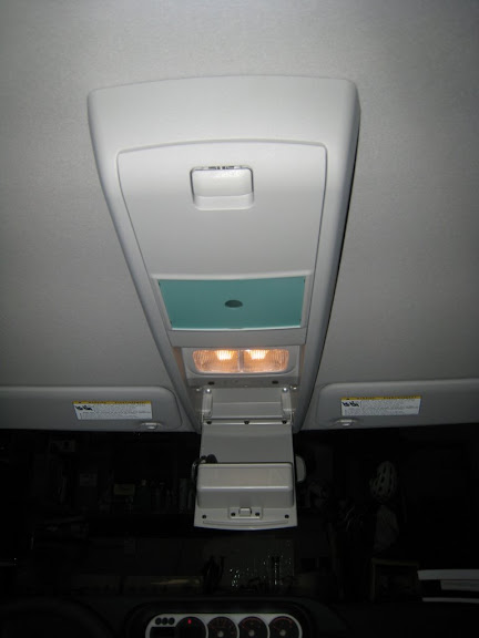

very easy install! The part comes with all the hardware, instructions and template needed to get it done. Just make sure to not over cut too much and follow the instructions as stated. The holes that you cut expose two brackets needed and a space for the compartments to fit inside the ceiling.
You will install a bracket in the front with two screws and anchors and the rest of the unit is held by two screws on that bracket and two more from an exposed bracket that is cut out near the center dome light.
I was trying to get it done quickly so i forgot to take photos during the install but here are several after install.
