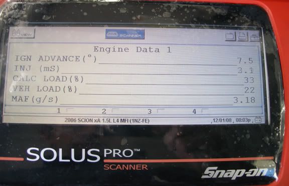

I got to play with a Snap-On scanner today and saw few interesting things:
MAF is shown by the ECM as grams-per-second data:
There are other parameters available for viewing, so it should be a matter of obtaining a special code for the Scangauge to display them:

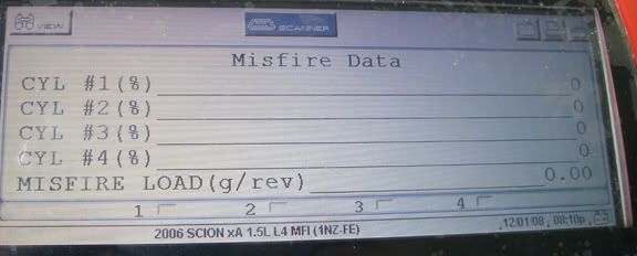

Misfire:

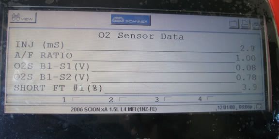

Air/Fuel Ratio is in the data stream, but does not change quickly. I had it stuck at 1.00 which is ideal 14.7 to 1 Air-to-Fuel ratio, but ECM does not update it is fast as O2 Sensor readings, so it does not seem to be of much use. Injector Pulse Width also shown:

Just saw in this thread: FS: Scangauge II Xgauges version that MAF readings can be displayed.
I already programmed mine to see the airflow data.
