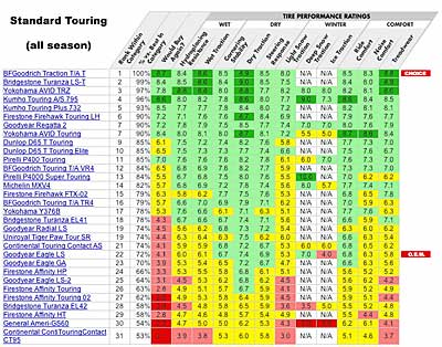

Originally Posted by Local Boy
hey Thomas? Forgive my ignorance but whats wrong with the stock tires compared to some of those other tires we see? Secifically, could you suggest a tire or at least some specs I should consider when looking for my next tires? I do mostly commuting, no snow, mostly dry, sometimes rainy. 15 rims, 2" drop.
I'm glad you asked!
Seriously, the Goodyear Eagle LS tires are NOT from the top of the list - anybody's list...
To give an example from when *I* was looking for new tires, here is a chart courtesy the TireRack...
(Click pic for a larger image.)
The chart is based on many millions of miles of customer experience with the tires listed, with the 'best' reviewed at the top of the list. (The list confirmed my own experiences with some of the tires listed.)
If you notice the two red 'tabs' on the right side of the chart, they mark the tires I chose (from personal experience and confirmed by the chat) and MUCH lower on the chart, the OEM tires...
(I should add that one of the most important criteria for me is wet handling since I live in the Seattle area...)
Not all tires are created equal, and cars seldom come with the absolute best choice - especially econo-boxes.
(I'm VERY happy with the BFGs compared to the OEM Goodyears!)
